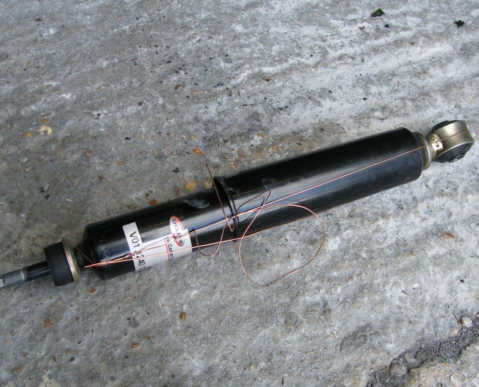

Frederick compressed the damper as far as it would go with one end on the floor and his weight on the other end. Then Ian tied a wire around to stop it from extending again.
Wired damper

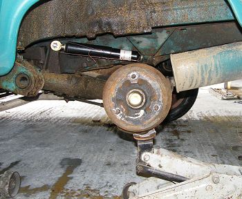

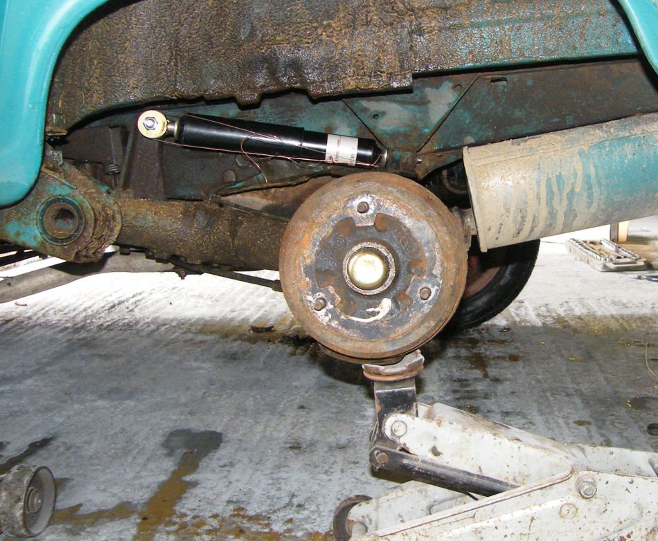

Even fully compressed the damper isn't short enough. A jack under the rear hub extended the damper mountings making it easy to fit the damper in position. Frederick tightened the front nut before cutting the wire.
From there all that remained was checking the metal bush housings lined up with the hole in the chassis bracket, then fitting the rear nuts (that are tightened right to the stop on these Delphi dampers).
Jack used to lift wheel
