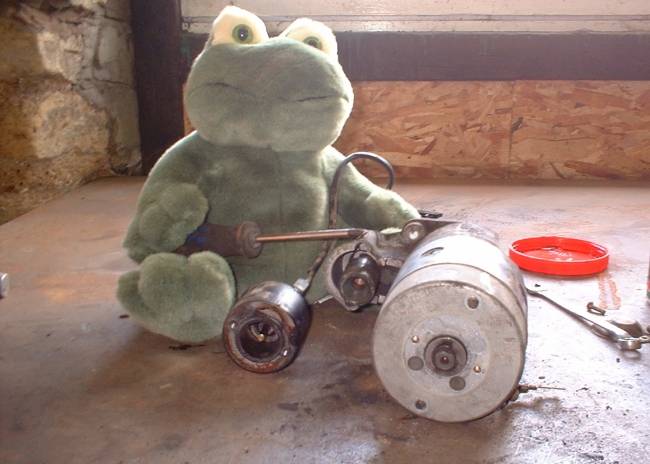

Leave Frederick the Frog for 5 minutes and he'll take something apart. This time it's a starter motor.

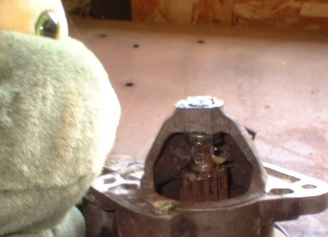

The problem is normally the starter motor solenoid. When you turn the key, the starter motor solenoid plunges backwards, engaging the starter gear with the flywheel. When the solenoid gets to the end of it's travel it makes an electrical contact which sends electricity into the starter motor which then turns the engine.
Unfortunately, there is an open path between the starter solenoid and the clutch, so the solenoid gets covered with dust from the clutch, which makes the electrical contacts dirty.
The solenoid can be removed from the starter motor by unscrewing two screws. The solenoid can then be cleaned using a solvent.

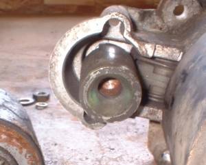

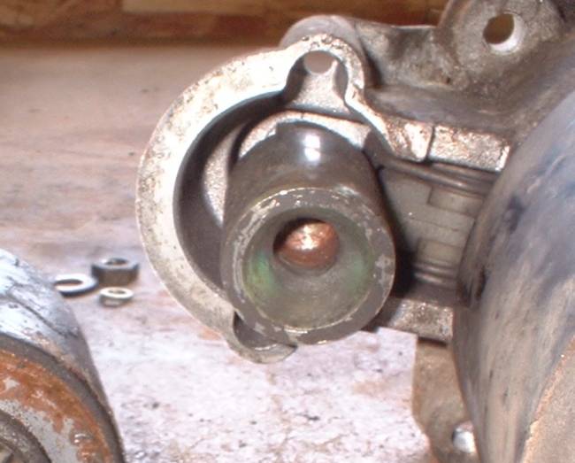

The starter shaft runs on a brass bearing. The bearing on this starter had become a little worn. I unscrewed the two 10mm headed bolts that pass through the starter motor, then pulled the shaft out of the bearing, and filled the bearing with grease. This should increase the life of the starter motor.
