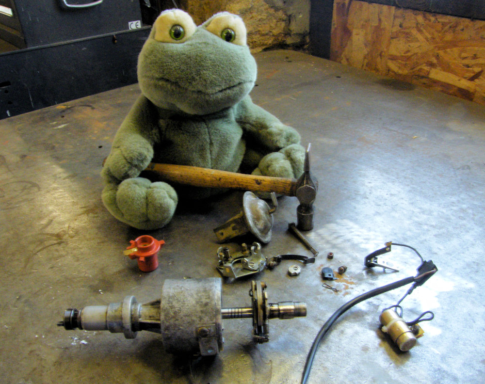

Frederick the frog to the rescue!
The distributor is 30 years old. The people that rebuild them reckon they fit slightly shorter springs to compentate for wear in the mechanism (and any stretching in the springs).

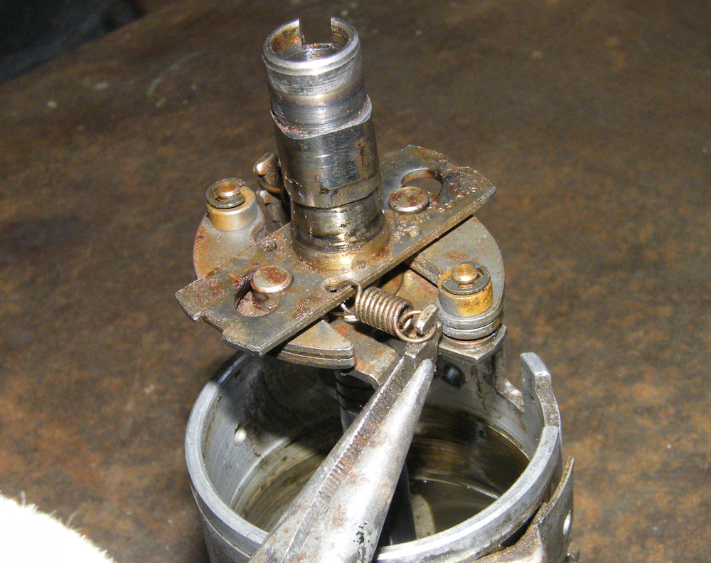

There are two springs inside the centrifugal advance - a thick one and a thin one. The thick one should have some slack - it only controls the advance from about halfway (2000rpm maybe). Below that the advance is controlled by the thin spring which should not have any slack. Mine was slack.
The springs are mounted on posts which can be bent back with some long nose pliers to take up the slack. I bent both of them back a little and it transformed the Gordini - now it seems to be very flexible about how the timing is set up and the pinking is gone.

If you have pinking try bending the post with the little spring to take up the slack and the post with the big spring just a tiny bit. That's all I did and it worked wonders!
