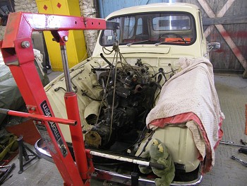

Ornella had been fitted with some replacement suspension parts from later cars. This had been a bad move as the suspension changed completely in 1968 and the later parts don't actually fit. At this point I was aware of later track rods and a later driveshaft that allowed one of the wheel bearings to wobble.
These are parts that would need to be removed anyway if the engine were removed, so I thought I'd fix the clutch at the same time.
![](ornella-repairs/mini-removing-engine.jpg)
The clutch had been replaced in the past, and while the parts used were probably sold as suitable for the early R4s they weren't. I had a lot of fun with the clutch and ended up changing the whole thing for an original Renault clutch recovered from a 1967 car.
I suspect Ornella's replacement clutch had been sold as a direct replacement for the original, but the actuation plate was the wrong size and it had destroyed the release bearing.
