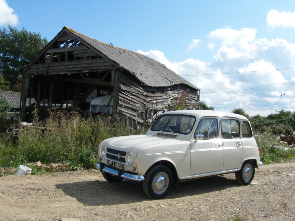

No restoration project is ever finished. Generally after the MOT you just start driving it and forget about all the other bits and pieces you intended to do. For this car there was a delay of 3 months between the MOT and the end of all the engine rebuilds which allowed a bit of time to add things like wheelarch liners.

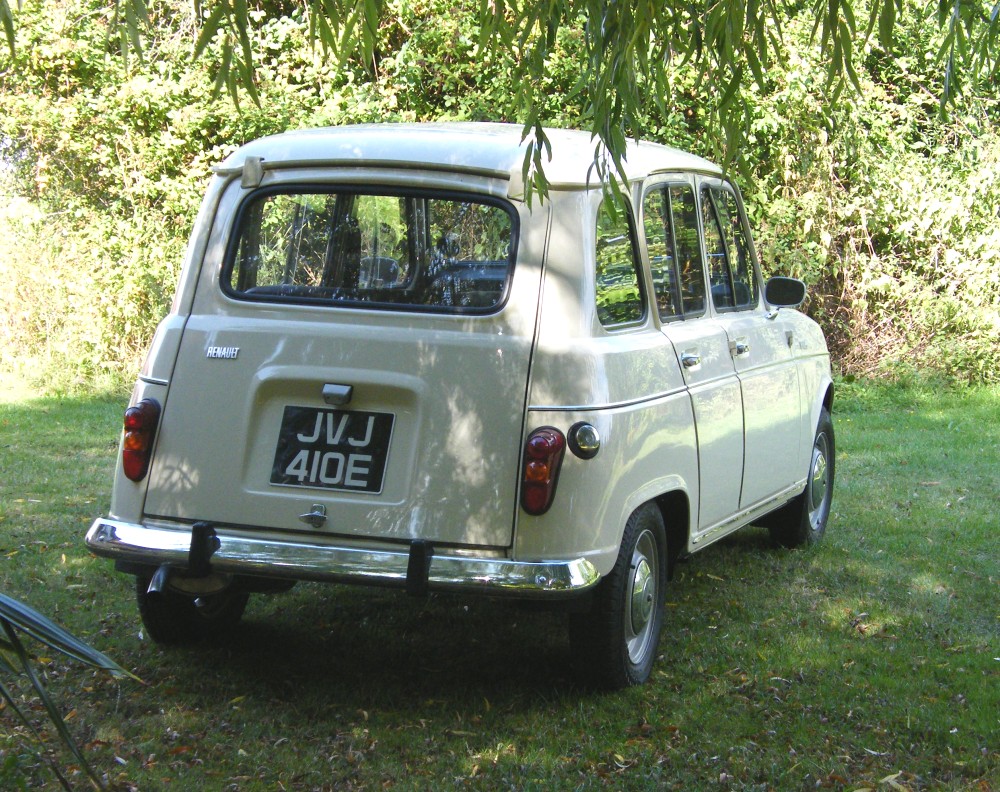

Now with the car finally running all that's left to do is development. But first some photos before she gets dirty.
She's turned out quite tidy, but that's not going to last for long. One of the downsides of living on a farm is the access track which gets very muddy during the rainy season (which is 11 months long in the UK). It's impossible to keep a car clean for more than 5 minutes around here.

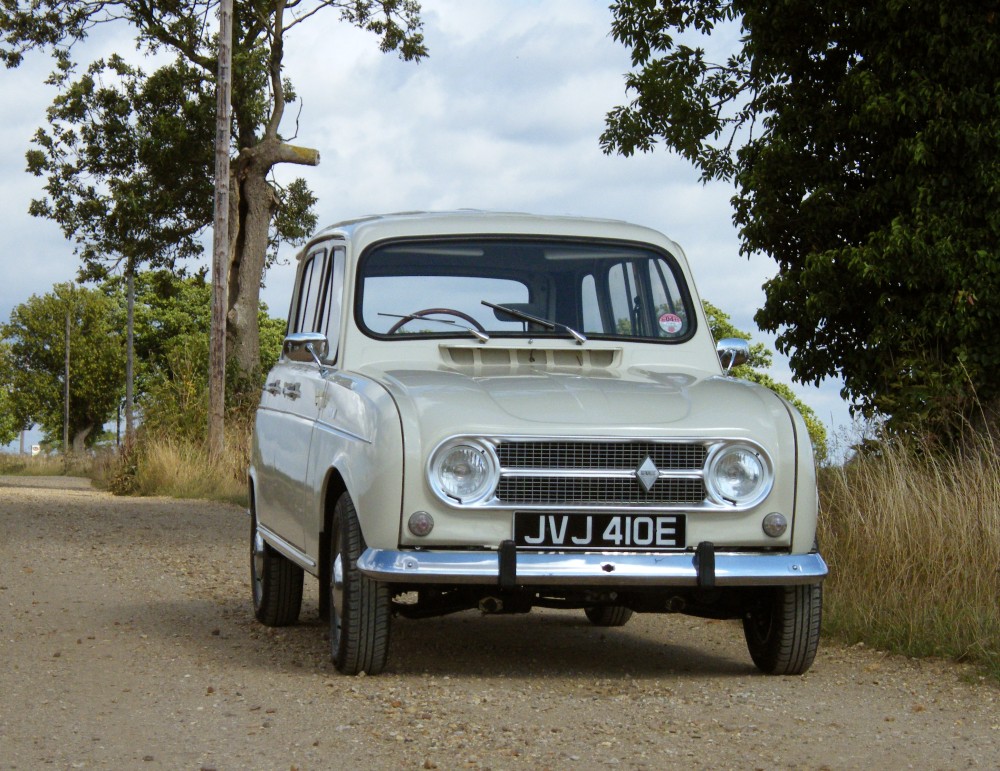

The project started out as a 1967 car so was originally fitted with the narrow grumpy looking front grille and the hard to find bumpers. I upgraded to 1968 spec as I preferred the look and it made the modifications easier.

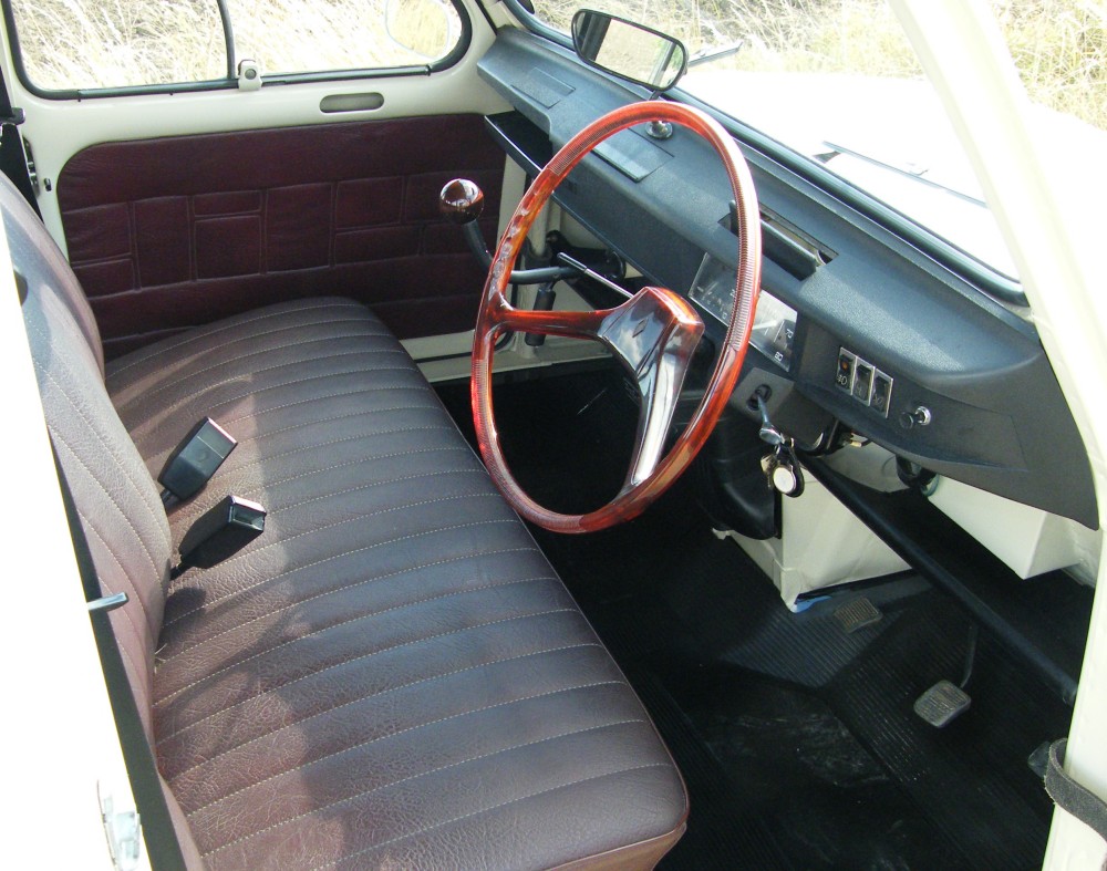

The super-cool translucent steering wheel and bench front seat from 1967 were high up on the list. I didn't like the beige dashboard from that year so ended up fitting a later black one. Otherwise the interior has remained remarkably faithful to the 1967 spec.

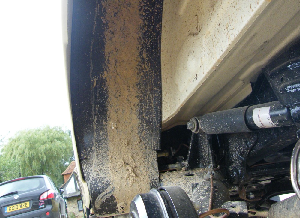

The part of the project I'm most pleased with are the wheelarch liners. We have a horrible access track to the house but the liners have so far taken all of the muck - the rest of the underneath is still immaculate.
